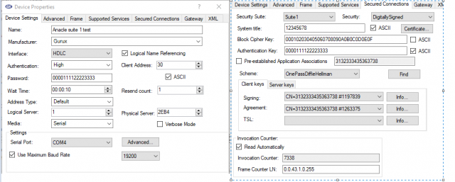

I am testing suite1 with digital signing but authentication get failed.
while observing AARQ frame sent by the gurux i found that the frame does not have digital signing tag,signature.
Also i think you missed invocation counter request in log.

Also attached the settings snaps.

as per point number 3 server should accept both digital signature and authentication applied by the client.
Our meter is able to accept both digital signature and authentication applied by the client but gurux not using this type so that we are unable to test suite1 with gurux.
can please help to provide digital signature and authentication?
