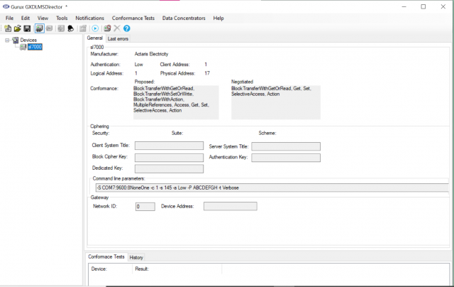

may be you can help me to read itron sl7000
i already can connect to meter
but i can not get obis code, the information was invalid

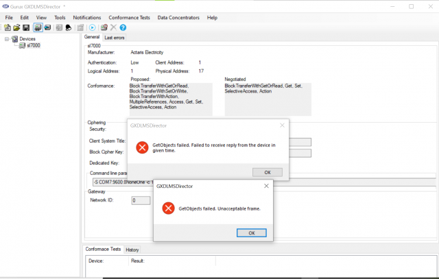

Hi Miko
Hi Miko
When i tried, the notif is "get object failed". can you help what should i do?
5 years 5 months ago
Can you connect without authentication? If you add a trace here; I can check it. Pictures don't tell anything.
