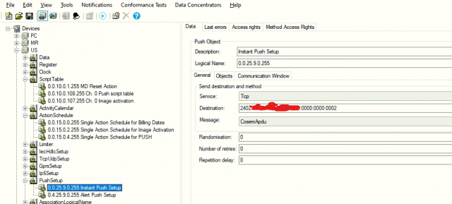

Where do I set the port number in push setup in GXDirector?
PFA screenshot of my push setup
5 years 4 months ago
Hi Mithun,
Hi Mithun,
It's usually after TPC/IP port. In your case it's not there, so you need to check it from the meter documentation. It might be that the meter is using port 4059.
