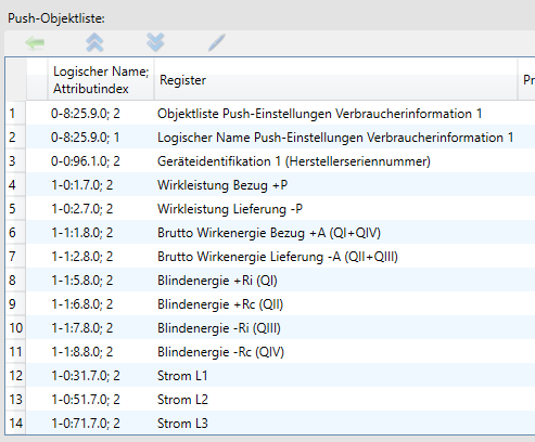

i asked my utility to give some evidence what objects are send.
According the utility, see attached image1, the object list every 5 seconds is much longer.
The is a second object list configured to be send every minute.
Does this mean that the other objects are then in the other PDUs?
And that i need to translate each PDU to separately ?
I also see that the actual values <UInt16 Value="0000" /> are all zero. That con not be the case.
Or do i misinterpret the results of the translator.
