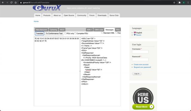

I am attaching on screenshot. Can you tell me the Method to Translate HEX value to XML. Method can be in any language(Java,C..). I need to value from HEX at server.
5 years 3 months ago
You can use Java, C# Python, Deplhi, or ANSI C++. You can use GXDLMSTranslator.MessageToXml method for that.
