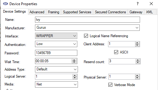

at the current stage I was
at the current stage I was able to advance only when I used Gurux.DLMS.Meter.Listener.Net
when i use GXDLMSDirector, i cant even connect to the meter, i use almost the same parametrs like in GXDLMSClient(true, 0x01, 0x01, Enums.Authentication.Low, "13456789",Enums.InterfaceType.WRAPPER)
when host is open, i try to connect with GXDLMSDirector, but then i got next message "the destination computer rejected the connection request"

these are the standards that
these are the standards that my meter supports
5 years 3 months ago
The server (or client) address might be different when the connection is established to the meter (GXDLMSDirector) or when the meter establishes the connection to the server (Gurux.DLMS.Meter.Listener.Net).
You need to use a different server address when you connect to the meter with GXDLMSDirector. Server and client addresses are not defined in standards. You need to ask the meter manufacturer what values you need to use.
