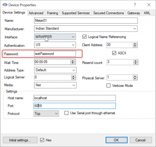

Do gurux allows to update meter password also. From security setup we were able to update Authentication and encryption key. Is it possible to update passwords of different association like MR,PC,US and FR. Attached screenshot for reference which need to be updated
5 years 2 months ago
Hi Naveen,
Hi Naveen,
You can update the password if you select the current association and then General-tab.
If "Update Low Password" or "Update High Password" are disabled, you can't update the password from the current association and you need to log in with higher authentication.
naveenChinnasamy
I can able to update password from gurux dlms director. From US association i can able to update MR and FR password but from FR i cannot able to update other passwords.
All password update works from US association.
