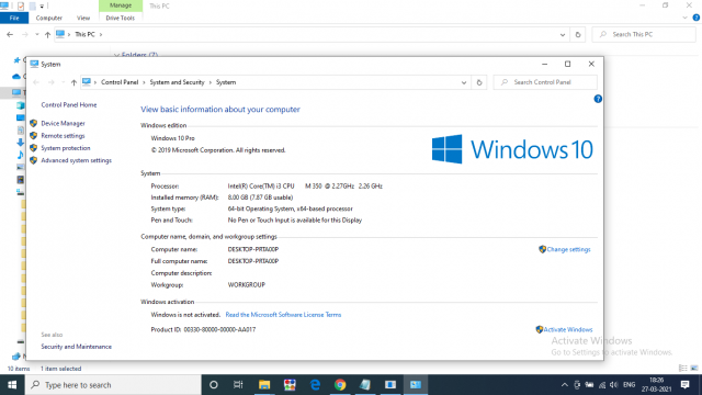

Dear Sir,
I am not able to install gurux in my laptop.
Please guide me.
I have attched my laptop configuration and also attaching notepad file of error showing details.
Thanks and regards
Milan
gamimilan6
5 years 2 months ago
Also added system
Also added system configuration

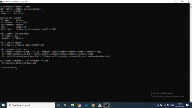

Hi Milan,
Hi Milan,
Can you run this in the command prompt?
dotnet --version
The result should be something like this:
5.0.201

Dear Miko,
Dear Miko,
As per your suggestion we tried by command prompt and I have shared a screenshot of the same.
Can you suggest me the any other method to check.
Thanks and regard
Milan

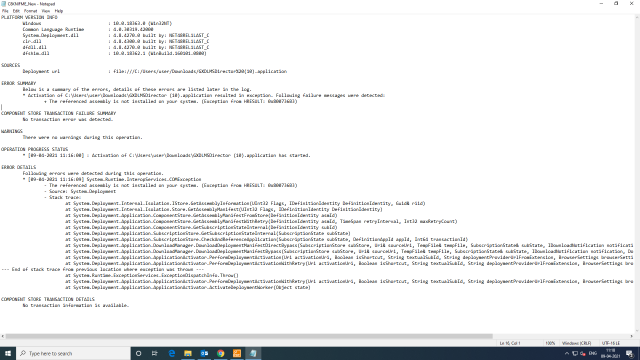

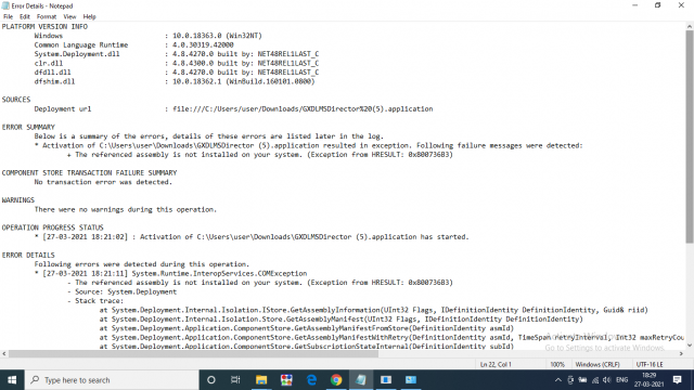

Dear Mikko,
Dear Mikko,
Please find error message.
PLATFORM VERSION INFO
Windows : 10.0.18363.0 (Win32NT)
Common Language Runtime : 4.0.30319.42000
System.Deployment.dll : 4.8.4270.0 built by: NET48REL1LAST_C
clr.dll : 4.8.4300.0 built by: NET48REL1LAST_C
dfdll.dll : 4.8.4270.0 built by: NET48REL1LAST_C
dfshim.dll : 10.0.18362.1 (WinBuild.160101.0800)
SOURCES
Deployment url : file:///C:/Users/user/Downloads/GXDLMSDirector%20(10).application
ERROR SUMMARY
Below is a summary of the errors, details of these errors are listed later in the log.
* Activation of C:\Users\user\Downloads\GXDLMSDirector (10).application resulted in exception. Following failure messages were detected:
+ The referenced assembly is not installed on your system. (Exception from HRESULT: 0x800736B3)
COMPONENT STORE TRANSACTION FAILURE SUMMARY
No transaction error was detected.
WARNINGS
There were no warnings during this operation.
OPERATION PROGRESS STATUS
* [09-04-2021 11:16:00] : Activation of C:\Users\user\Downloads\GXDLMSDirector (10).application has started.
ERROR DETAILS
Following errors were detected during this operation.
* [09-04-2021 11:16:09] System.Runtime.InteropServices.COMException
- The referenced assembly is not installed on your system. (Exception from HRESULT: 0x800736B3)
- Source: System.Deployment
- Stack trace:
at System.Deployment.Internal.Isolation.IStore.GetAssemblyInformation(UInt32 Flags, IDefinitionIdentity DefinitionIdentity, Guid& riid)
at System.Deployment.Internal.Isolation.Store.GetAssemblyManifest(UInt32 Flags, IDefinitionIdentity DefinitionIdentity)
at System.Deployment.Application.ComponentStore.GetAssemblyManifestFromStore(DefinitionIdentity asmId)
at System.Deployment.Application.ComponentStore.GetAssemblyManifestWithRetry(DefinitionIdentity asmId, TimeSpan retryInterval, Int32 maxRetryCount)
at System.Deployment.Application.ComponentStore.GetSubscriptionStateInternal(DefinitionIdentity subId)
at System.Deployment.Application.SubscriptionStore.GetSubscriptionStateInternal(SubscriptionState subState)
at System.Deployment.Application.SubscriptionStore.CheckAndReferenceApplication(SubscriptionState subState, DefinitionAppId appId, Int64 transactionId)
at System.Deployment.Application.DownloadManager.DownloadDeploymentManifestDirectBypass(SubscriptionStore subStore, Uri& sourceUri, TempFile& tempFile, SubscriptionState& subState, IDownloadNotification notification, DownloadOptions options, ServerInformation& serverInformation)
at System.Deployment.Application.DownloadManager.DownloadDeploymentManifestBypass(SubscriptionStore subStore, Uri& sourceUri, TempFile& tempFile, SubscriptionState& subState, IDownloadNotification notification, DownloadOptions options)
at System.Deployment.Application.ApplicationActivator.PerformDeploymentActivation(Uri activationUri, Boolean isShortcut, String textualSubId, String deploymentProviderUrlFromExtension, BrowserSettings browserSettings, String& errorPageUrl, Uri& deploymentUri)
at System.Deployment.Application.ApplicationActivator.PerformDeploymentActivationWithRetry(Uri activationUri, Boolean isShortcut, String textualSubId, String deploymentProviderUrlFromExtension, BrowserSettings browserSettings, String& errorPageUrl)
--- End of stack trace from previous location where exception was thrown ---
at System.Runtime.ExceptionServices.ExceptionDispatchInfo.Throw()
at System.Deployment.Application.ApplicationActivator.ActivateDeploymentWorker(Object state)
COMPONENT STORE TRANSACTION DETAILS
No transaction information is available.
Thanks and Regards
Milan
Hi Mialn,
Hi Mialn,
This error is seen once. The PC was corrupted. Try to run this:
SFC /SCANNOW
