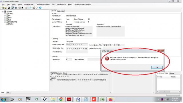

i am reading IS 15959-2 METER ,PUSH Association connection established but While downloading the PUSH Objects client throws an error as service exception,getting objects failed.We have given 8byte-System title.
Can you please support .I am attaching the screen shot.

Meter doesn't allow you to read the push list with this association. GXDLMSDirector has proposed Get-service, but the meter doesn't accept it. You can see accepted services from the Negotiated conformance view. There are only two services accepted.
