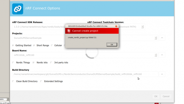

I am wanted to explore DLMS data reading using a nordic nRF9160 IC. I tried following the instruction and tried to import the project. But unfortunately, I am getting import error. I am attaching snap of error i am getting.

Thanks for the update. Yes I am using the one provided by Nordic itself. The error was something like Net Raw mode not found or something.
I commented CONFIG_NET_RAW_MODE=y in prj.conf file, after which i was able to open as project, compile and test.
