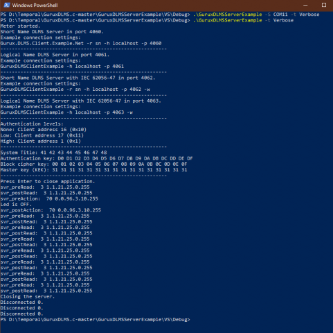

Thanks a lot for your kind answer! I have cloned and compiled the code you adviced without problems. I have a serial com port COM11 in my device manager/serial ports. When I run the exe with the suggested flags (-S COM11 -t Verbose) it seems that the thread is not launched. If I run only with -t Verbose the thread is launched... please see attached picture. Am I doing something wrong? Is there any additional serial port configuration I am missing? (like baud rate, number of bits, parity, stop bit?)

ANSI C is not support serial port. Try with C# version.
Parameters are:
-S COM11 -t Verbose
Profile picture for user rafamarca
rafamarca
5 years 4 months ago
I have got the server up and running though serial port. Thanks a lot for your great support!! super!!
