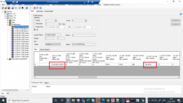

HI Mikko,
I am using Gurux DLMS (C++) version. The few values of Instantaneous-profile is not in readable format.
When I read same using DLMSDirector tool, then I getting different format for the same.
I am sharing the fetched data of instantaneous-profile of my sample program as well as DLMSDirector tool.
I will email the log of DLMSDirector tool for the same.
Kindly check and suggest asap.
My sample application data:
fetched Capture-objects:
[0.0.1.0.0.255, 1.0.31.7.0.255, 1.0.51.7.0.255, 1.0.71.7.0.255, 1.0.32.7.0.255, 1.0.52.7.0.255, 1.0.72.7.0.255, 1.0.33.7.0.255, 1.0.53.7.0.255, 1.0.73.7.0.255, 1.0.13.7.0.255, 1.0.14.7.0.255, 1.0.9.7.0.255, 1.0.1.7.0.255, 1.0.3.7.0.255, 1.0.1.8.0.255, 1.0.2.8.0.255, 1.0.9.8.0.255, 1.0.10.8.0.255, 0.0.96.7.0.255, 0.0.94.91.8.255, 0.0.94.91.0.255, 0.0.0.1.0.255, 0.0.96.2.0.255, 0.0.0.1.2.255, 1.0.36.7.0.255, 1.0.56.7.0.255, 1.0.76.7.0.255, 1.0.128.7.38.255, 1.0.128.7.39.255, 1.0.128.7.40.255, 1.0.128.7.41.255, 1.0.128.7.53.255, 1.0.128.7.54.255, 1.0.128.7.55.255, 1.0.128.7.45.255, 1.0.128.7.35.255, 1.0.128.7.36.255, 1.0.128.7.37.255, 1.0.128.7.46.255, 1.0.128.8.28.255, 1.0.128.7.43.255, 1.0.128.8.29.255, 1.0.128.7.44.255, 1.0.128.8.34.255, 1.0.128.7.49.255, 1.0.128.7.68.255, 1.0.128.7.65.255, 1.0.128.7.66.255, 1.0.128.7.67.255, 1.0.128.7.72.255, 1.0.128.7.69.255, 1.0.128.7.70.255, 1.0.128.7.71.255, 1.0.128.7.17.255, 1.0.128.7.21.255, 1.0.128.7.18.255, 1.0.128.7.22.255, 1.0.128.7.19.255, 1.0.128.7.23.255, 1.0.5.8.0.255, 1.0.6.8.0.255, 1.0.7.8.0.255, 1.0.8.8.0.255, 1.0.16.8.0.255, 1.0.128.7.149.255, 1.0.128.8.7.255, 1.0.128.8.8.255, 1.0.128.8.9.255, 1.0.128.8.10.255, 1.0.128.8.11.255, 1.0.128.8.12.255, 1.0.128.8.13.255, 1.0.128.8.14.255, 1.0.128.8.190.255, 1.0.128.8.191.255, 1.0.128.8.192.255, 1.0.128.8.193.255]
Fetched corresponding values:
13-3-2021 10:25:26 | 262 | 262 | 262 | 6610 | 6612 | 6609 | 775 | 775 | 775 | 775 | 4998 | 52 | 40 | 32 | 392770 | 14 | 506508 | 39 | 6 | 73497 | 17 | 4 | 2 | åÿ
when I split values string I get 79 values.
DLMSDirector data:
13-03-2021 10:10:25 262 262 262 6612 6607 6609 775 775 776 775 5000 52 40 32 392669 14 506377 39 6 73497 17 4 2 01-03-2021 00:00:* 13 13 13 73416 73412 286 04 04 04 0 0 0 00 00 00 0 0 0 00 00 00 8 01 00 00 73501 04 00 00 0 00 00 00 37798739 66943763 20379479 1252905 3903814 1494397 7 3403795 0 69256 0 69177 0 69231 319203 34 0 12 392655 319225 7728 303957 0 0 0 0 0 0 -7728 -303957 0 0
Pradson
5 years 4 months ago
I don't know what object type your meter is using for 0.0.1.2.0.255, but I believe that your UI type is not set because it's octet-string. Set UI-Datatype to DLMS_DATA_TYPE_DATE_TIME for 0.0.1.2.0.255 and you can see the value as a date-time string.
