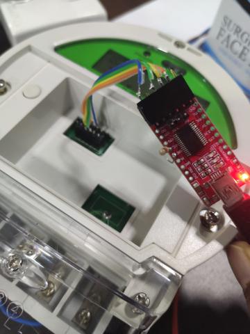

When I was trying to read
When I was trying to read parameters but it gave me an error. What is the reason?
Code-python main.py -S /dev/ttyUSB0:2400:8None1 -t Verbose -g "1.0.32.7.0.255:2" -o meter.xml

5 years 4 months ago
The checksum is wrong. Try to read the meter again. This might happened if the connection line is not very good and the data is corrupted during the transmission.
If you add o -parameter you can save the association view to the file and reading is faster.

Can you tell me what is the error.
(I attached an image to show how I connect the meter and raspberry. Meter serial port connected to raspberry using FTDI converter.)
