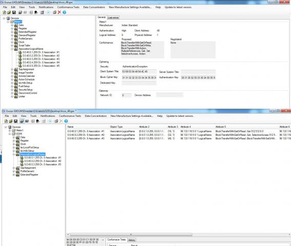

Dear Mikko,
When i connected High association (DLMS gurux C server lib.) only showing current association OBIS code. But not showing other association or low, lower association OBIS code. how to solve this?
In image other meter showing OBIS code.
5 years 5 months ago
The meter will send only connected association information. You are not allowed to show other associations and DLMS conformance tests will fail if you show other associations.
So, this is not possible.
