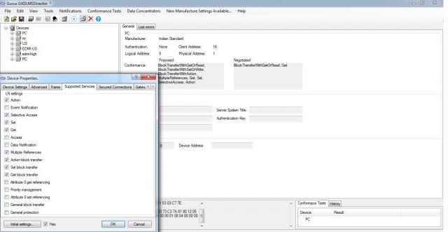

In PC Association xDLMSContextInfo.conformance attribute i given ont GET but in the gurux client it is showing all.
please help me where is the problem
5 years 7 months ago
I tested this and it worked as expected. First, make sure that you have the latest version. Then select device properties and select the "Supported services" -tab. Make sure that you have selected only Get-service.
Ashok_Chowdary
Thanks for reply,
device properties and select the "Supported services" -tab get and remaining services also,But in Negotiated place has the services what we given in the code. for PC, I given Only GET.
Please clarify me where I am wrong?
In the server side:
Set proposed service. Negotiated service will tell what services the client and server are negotiated to use. It's updated every time when a client makes a new connection.
Ashok_Chowdary
I checked with another DLMS meter there it is working fine.
please check below screen shot
Proposed conformance is set for the association view. In that way, each association view might offer different services.
Check that your association is defined like this:
associationX.xDLMSContextInfo.conformance = DLMS_CONFORMANCE_GET;
Don't set the Negotiated service directly.

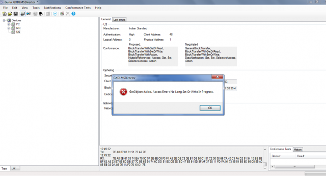

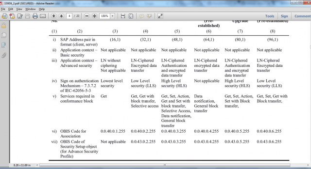

Ashok_Chowdary
5 years 6 months ago
now it is working fine with PC&MR associations but, I am getting problem with US association.
as per IS15959 sheet I given conformance services for US is:
highAssociation.xDLMSContextInfo.conformance = (DLMS_CONFORMANCE)(DLMS_CONFORMANCE_BLOCK_TRANSFER_WITH_ACTION |
DLMS_CONFORMANCE_BLOCK_TRANSFER_WITH_SET_OR_WRITE |
DLMS_CONFORMANCE_BLOCK_TRANSFER_WITH_GET_OR_READ |
DLMS_CONFORMANCE_SET |
DLMS_CONFORMANCE_SELECTIVE_ACCESS |
DLMS_CONFORMANCE_ACTION |
DLMS_CONFORMANCE_GET|
DLMS_CONFORMANCE_DATA_NOTIFICATION|
DLMS_CONFORMANCE_GENERAL_BLOCK_TRANSFER);
but when i selected GENERAL_BLOCK_TRANSFER in proposed services of Gurux Client. it is updating at negotiated service and establishing the connection, but problem is after connection establish I gave Refresh then it throwing error as : get Objects failed.Access Error:No long set or write in the progress.
I am attached screen shot please check it.
please help me why it is showing like this?
GBT expects that all the data is read for the memory before data is starting to send. It might be possible to use GBT if you have enough memory, but if you want to read example association view or profile generic the amount might be huge. For this reason, GBT is not set in default for ANSI C.

The IS15959 standared says that for US Association GBT is required conformance Service. if we not given this it may be fail?
No, you define conformance in the settings file. GBT and ciphering are a bad combination. If you are using GBT and ciphering you must read all data to the memory. Then you need to encrypt it and then send encrypted data using GBT.
For this reason, GBT is only available for push messages in Indian standards because there is a max size of push messages and it's possible to encrypt them. This is not possible if the client app is reading example profile generic buffer.
