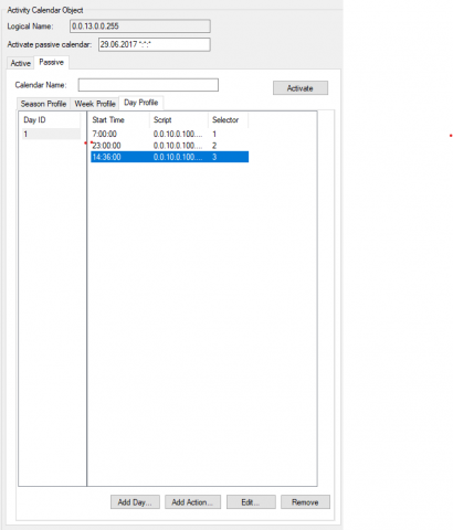

I think i have almost
I think i have almost understood what i need to do. I checked Script Table in Director (0.0.10.0.100.255). There is preset with 8 tariffs. After that i checked Activity Calendar passive section. There was a single day profile with two values: 7:00 and 23:00. Both of these values point on 0.0.10.0.100.255 script but with different selectors (1, 2). But if I add another schedule with the selector value 3 (tariff 3) 2 minutes later than the current time, display still shows tariff 1. I guess i missed some important detail.

You can try to execute scripts by yourself and verify that it's working. Find Script table object 0.1.10.0.100.255 and select the script that you want to call. Example script #3. Then press "Execute" button and the tariff should be changed.
For the activity calendar, you can define what script is called and when. You need to make sure that week profile is calling day id #1. You can check that if you read the week profile and check that day is selected. Then you need also to check that the current season is active.
The activity calendar is not quite easy to configure.

OK. The meter doesn't allow direct execution. You must configure the activity calendar. Read season profiles and check what is active season. Then Check what week profile it will call. Then check what day profile week profile is calling. Then add a new execution time for that day profile.

Yes, i have checked it
Yes, i have checked it already. Like i said before there was preset by manufacturer in activity calendar. Am i understanding correctly that if "Activate passive calendar" attribute is "29.06.2017 *:*:*" then the passive mode has already been used for 3.5 years? If so, then I don`t understand why the new rules I added to the day profile don`t work? Or is the calendar still in active mode?
P.S. Active mode is read only for me.
DenisMalakhov
5 years 5 months ago
OMG, it really used Active
OMG, it really used Active Mode. The meter was released in 2019 and it could not physically go into passive calendar mode... It`s working for now. Thank you very much for your help. Now i need to program it with .Net library. If i will get stucked so i will start new topic.
I forget to say that after you have added date-time you need to activate the calendar. Press the Activate button. Then read the object again and change "Passive" tab to "Active". You should see the new values there. After you have activated the calendar the new values are in use.
