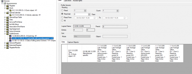

In the attached image you can see the desired item to read (load profile).
