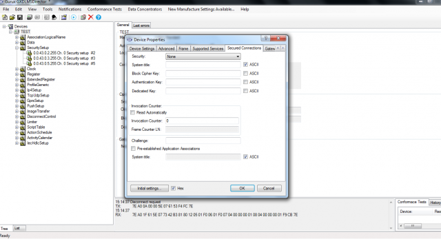

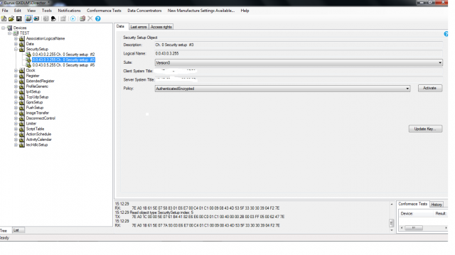

SecuritySetup for High Association(0.0.43.0.3.255) Activated as AuthenticationEncryption policy.
But next time when i am connecting gurux through none mode it is connected successfully.
Similarly happening in MR Association also.
I am thinking that connection has occur through Security: AuthenticationEncryption instead of NONE.
Please help me where is the wrong.

Connecting through Security
Connecting through Security none it is connecting sucessfully

Each association view should have its own security setup object. When you activate the security policy it will affect only that association view. IN ANSI C source code this is done in svr_isTarget.
Try to connect using GMAC authentication. Then change the security policy to Encrypted and you can't connect without authentication when you use GMAC. Ciphering is not required If you try to connect with Low authentication.
