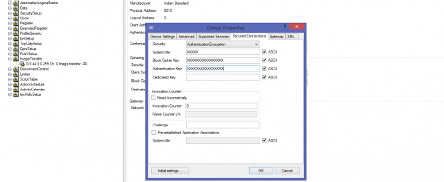

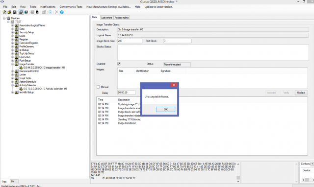

image transfer through gurux dlmsDirector failed when I applied Secured connections(authentication&encryption) while login.
After clicked on update button few seconds later "Unacceptable frame" error came
with out keys(means Security connections as NONE) it is working fine.
Please help me where is the problem.

Meter is replying to the wrong frame. I can't get any information from the pictures. Add the last frame that the meter sends as a string and I'll check what is wrong in the frame.
