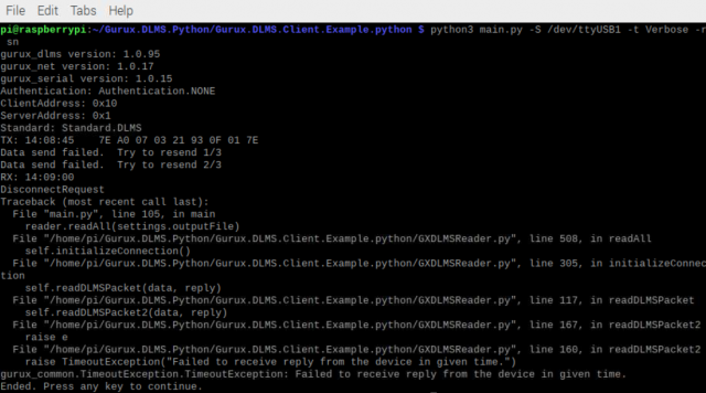

I have a problem with Gurux.DLMS for python on Raspberry PI 4.
I'd like to read data from meter Landis Gyr E650 using optical interface with USB. I connected USB to raspberry and I've done step by step your instructions for python Gurux.DLMS.
I check a connection meter Landis Gyr E650 and optical interface with USB on GXDLMSDriector (Windows10) and It works. I can read data.
My output of console is below.
python main.py -S /dev/ttyUSB0
gurux_dlms version: 1.0.95
gurux_net version: 1.0.17
gurux_serial version: 1.0.15
ClientAddress: 0x10
Standard: Standard.DLMS
RX: 10:12:44
File "main.py", line 105, in main
File "/home/pi/Gurux.DLMS.Python/Gurux.DLMS.Client.Example.python/GXDLMSReader.py", line 508, in readAll
self.initializeConnection()
File "/home/pi/Gurux.DLMS.Python/Gurux.DLMS.Client.Example.python/GXDLMSReader.py", line 305, in initializeConnection
File "/home/pi/Gurux.DLMS.Python/Gurux.DLMS.Client.Example.python/GXDLMSReader.py", line 117, in readDLMSPacket
File "/home/pi/Gurux.DLMS.Python/Gurux.DLMS.Client.Example.python/GXDLMSReader.py", line 167, in readDLMSPacket2
raise e
TimeoutException: Failed to receive reply from the device in given time.

I tried to run python code on PI several times and I got an answer from meter. I will paste it below.
python3 main.py -S /dev/ttyUSB3 -t Verbose -r sn
ClientAddress: 0x10
TX: 15:30:31 7E A0 07 03 21 93 0F 01 7E
RX: 15:30:31 7E A0 1E 21 03 73 C3 7A 81 80 12 05 01 80 06 01 3E 07 04 00 00 00 01 08 04 00 00 00 01 07 22 7E
TX: 15:30:31 7E A0 2B 03 21 10 FB AF E6 E6 00 60 1D A1 09 06 07 60 85 74 05 08 01 02 BE 10 04 0E 01 00 00 00 06 5F 1F 04 00 1C 03 20 FF FF 80 AB 7E
RX: 15:30:31 7E A0 2D 21 03 30 63 63 E6 E7 00 61 1F A1 09 06 07 60 85 74 05 08 01 02 A2 03 02 01 01 A3 05 A1 03 02 01 01 BE 06 04 04 0E 01 06 00 7E 79 7E
TX: 15:30:31 7E A0 07 03 21 53 03 C7 7E
Connection is permanently rejected
No reason is given.

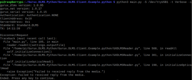

python3 main.py -S /dev/ttyUSB7 -i -t Verbose
ClientAddress: 0x10
TX: 12:38:49 /?!
File "/home/pi/Gurux.DLMS.Python/Gurux.DLMS.Client.Example.python/GXDLMSReader.py", line 301, in initializeConnection
self.initializeOpticalHead()
File "/home/pi/Gurux.DLMS.Python/Gurux.DLMS.Client.Example.python/GXDLMSReader.py", line 198, in initializeOpticalHead
raise Exception("Failed to received reply from the media.")
Exception: Failed to received reply from the media.

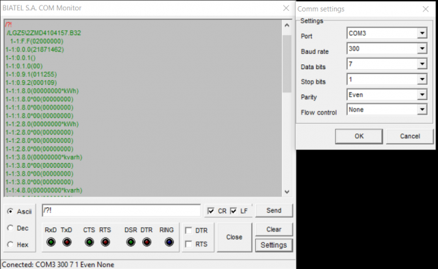

I check my serial port communication on Windows using an application for COM monitoring. A screen of the operation is below.
I sent /?! and got the answer. I think something is wrong with the python library if I'd like to use an optical probe.

Can you see if the Pi app is sending <CR><LF> after "/?!"? The meter should reply and now there is nothing.
Krzysztof S.
5 years 7 months ago
I've checked it during runing python code on Windows. The app sent <CR><LF> after "/?!", but there was no reply from meter.
But Biatel COM Monitor which I sent the image above was able to communicate with meter and get data.
Biatel application is using IEC 62056-21 readout mode and not DLMS.
