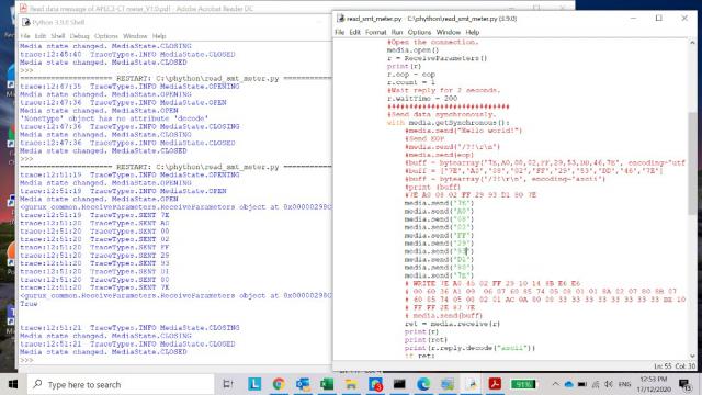

I am trying to perform coding in Python to read from my smart meter via TCP. I am unable to obtain the reply and decode.
Thank you in advance for your kind assistance.

I need to warn that DLMS is not an easy protocol. You will save a lot of time if you use our open source library. The reason, why the meter is not replying, might be anything. Your client or server address is wrong or your check sum is not correct, etc.

Without the authentication, you can only see the clock, Association, SAP Assignment, COSEM Logical device name, and Device ID. You need to change the authentication level higher to read more data.
Try to read your meter with GXDLMSDirector first. Using GXDLMSDirector you can get an idea from your meter and how to operate with it.

Yes I did use earlier but it only prompt for error timeout. I have increased the timeout to bigger ones but to no avail.
5 years 5 months ago
Check your client address. When you change the authentication level you also need to change your client address. You should get this information from the meter documentation.
Without authentication, you can't read anything else.
