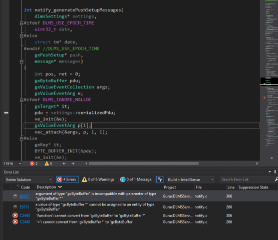

Hope everything is fine.
First, we want to thank for your hard work.
Second, we downloaded the latest release and we are starting the testing so we opened this discussion to report the bugs.
When we open the new project and build it, there is some errors mainly do to some missing casting (check the picture).
The issue is that in the file notify.c in the notify_generatePushSetupMessages() function, you replaced "gxByteBuffer* pdu" by "gxByteBuffer pdu". But you didn't change "pdu = settings->serializedPdu" knowing that the dlmsSettings structure contains "gxByteBuffer* serializedPdu".
In the same function you used the function notify_addData() that takes "gxByteBuffer* buff" as the 4 elements. But you did pass the variable pdu that it is not a pointer.

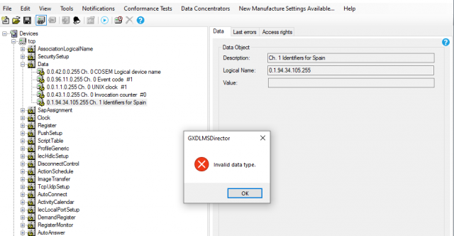

Let me highlight another problem that we expected to be solved.
The 2 objects of type gxData with value type equal to array[2] of bit-string[256] and array[2] of octet-string[12] respectively are causing some problems.
In fact, before this release: we were able to save these objects and then read them normally on the client side but we were not able to load them. So when we try to restart the meter it was giving "Failed to load settings!".
Now with this release : we are not even able to read these objects, the director is giving invalid data type (check the picture). And when we try to restart the meter it is giving "Assertion failed: 0".
If you please can check it and solve the issues around these 2 value types. And inform us if you have any idea why this is happening.

We downloaded the latest version and we are testing it right now. We noticed all the improvements and optimization made to the serialization.
But till now the above issue is still here. When we create an object gxData of value type array[2] of bit-string[256] or array[2] of octet-string[12], it is still unreadable by the director (invalid data type) and when trying to load the meter it is giving "assertion failed"
If you please can check it and maybe add these 2 objects to the next release.
Best Regards,
Lara Wakim
PS: you can find below the 2 methods to add these 2 objects. This will also help you to repeat more easily the problem.
int addEventLogFilter_standardEventLog()
int ret;
const unsigned char ln[6] = { 0, 1, 94, 34, 105, 255 };
if ((ret = INIT_OBJECT(eventLogFilter_standardEventLog, DLMS_OBJECT_TYPE_DATA, ln)) == 0)
static char BUFFER[2][32]; //32*8= 256
for (int i = 0; i < 32; i++)
//Array[0]=default values: 1 for all bits (all events will be log into the buffer)
BUFFER[0][i] = 0xff;
//Array[1]=default values: 0 for all bit (no event will be sent as notification event)
BUFFER[1][i] = 0;
static dlmsVARIANT ARRAY[2];
GX_BIT_STRING(ARRAY[0], BUFFER[0], 256);
GX_BIT_STRING(ARRAY[1], BUFFER[1], 256);
static variantArray tmp;
VA_ATTACH(tmp, ARRAY, 2);
GX_ARRAY(eventLogFilter_standardEventLog.value, tmp);
return ret;
int addTimestampForNewCalendarActivation()
int ret;
const unsigned char ln[6] = { 1, 0, 94, 34, 130, 255 };
if ((ret = INIT_OBJECT(timestampForNewCalendarActivation, DLMS_OBJECT_TYPE_DATA, ln)) == 0)
//Array[3] of octet-string[12]
//Array[x] Date&Time for contract x (x =1..3)
static unsigned char BUFFER[3][12];
static dlmsVARIANT ARRAY[3];
GX_OCTECT_STRING(ARRAY[0], BUFFER[0], sizeof(BUFFER[0]));
GX_OCTECT_STRING(ARRAY[1], BUFFER[1], sizeof(BUFFER[1]));
GX_OCTECT_STRING(ARRAY[2], BUFFER[2], sizeof(BUFFER[2]));
VA_ATTACH(tmp, ARRAY, 3);
GX_ARRAY(timestampForNewCalendarActivation.value, tmp);
return ret;

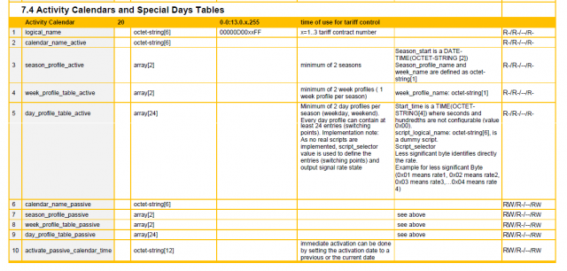

- Finally there is a last feature that is not taken in consideration yet. In fact before checking all this step starting with the season, we should check if the current date is included in the special day table. If not, we follow the step described above. If yes, we jump directly to the day profile table because with each special day we have its own dayId leading us to the current tariff.
Sorry for this long text and explanation.
Hope you will be able to add the missing piece and correct the bugs. If you need more information or you need any help feel free to ask.
Best regards,
Lara Wakim
lara.wakim
5 years 9 months ago
In reply to Hi Mikko, by lara.wakim

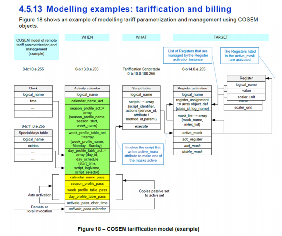

We are sorry for the above long explanation.
After checking the blue book, we noticed that you followed the attached scheme (check the picture) and this is exactly what we want and the implementation that you did is almost done and correct. We noticed that you already created the tariffication script table and the register activation.
To sum up what is missing in the activity calendar:
1- To check the special day table before checking the season table
2 - When checking the season table, we should only see in which interval season our current date is included (not compare equally)
3 - When checking the day table, we should also see in which interval of time our current time (hours and minutes) is included and then we can trigger the tariffication script with the expected script selector.
We are very grateful for your hard work.

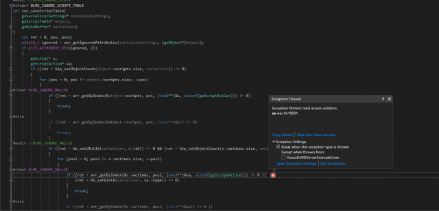

Hello Mikko,
Hello Mikko,
We were updating the tarrification script table to match our requirements and surprisingly when trying to run it: in the gxserializer.c file -> in the ser_savescripttable() function -> the "(ret = arr_getByIndex(&s->actions, pos2, (void**)&sa, sizeof(gxScriptAction))) != 0" was throwing an exception read access violation (check the picture).
To easily repeat the exception simply replace the addTarifficationScriptTable() by the following, you should have the same problem (if you also please check if we didn't write something wrong):
int addTarifficationScriptTable()
int ret;
static gxScript SCRIPTS[4] = { 0 };
static gxScriptAction ACTIONS1[1] = { 0 };
static gxScriptAction ACTIONS2[1] = { 0 };
static gxScriptAction ACTIONS3[1] = { 0 };
static gxScriptAction ACTIONS4[1] = { 0 };
const unsigned char ln[6] = { 0, 0, 10, 0, 100, 255 };
if ((ret = INIT_OBJECT(tarifficationScriptTable, DLMS_OBJECT_TYPE_SCRIPT_TABLE, ln)) == 0)
SCRIPTS[0].id = 1; //rate 1
SCRIPTS[1].id = 2; //rate 2
SCRIPTS[2].id = 3; //rate 3
SCRIPTS[3].id = 4; //rate 4
ARR_ATTACH(tarifficationScriptTable.scripts, SCRIPTS, 4);
ARR_ATTACH(SCRIPTS[0].actions, ACTIONS1, 1);
ACTIONS1[0].type = DLMS_SCRIPT_ACTION_TYPE_WRITE;
ACTIONS1[0].target = BASE(registerActivation);
ACTIONS1[0].index = 4;
var_init(&ACTIONS1[0].parameter);
//Action data is Int8 zero.
GX_INT8(ACTIONS1[0].parameter) = 3;
ARR_ATTACH(SCRIPTS[1].actions, ACTIONS2, 1);
ACTIONS2[0].type = DLMS_SCRIPT_ACTION_TYPE_WRITE;
ACTIONS2[0].target = BASE(registerActivation);
ACTIONS2[0].index = 4;
var_init(&ACTIONS2[0].parameter);
GX_INT8(ACTIONS2[0].parameter) = 0;
ARR_ATTACH(SCRIPTS[2].actions, ACTIONS3, 1);
ACTIONS3[0].type = DLMS_SCRIPT_ACTION_TYPE_WRITE;
ACTIONS3[0].target = BASE(registerActivation);
ACTIONS3[0].index = 4;
var_init(&ACTIONS3[0].parameter);
GX_INT8(ACTIONS3[0].parameter) = 0;
ARR_ATTACH(SCRIPTS[3].actions, ACTIONS4, 1);
ACTIONS4[0].type = DLMS_SCRIPT_ACTION_TYPE_WRITE;
ACTIONS4[0].target = BASE(registerActivation);
ACTIONS4[0].index = 4;
var_init(&ACTIONS4[0].parameter);
GX_INT8(ACTIONS4[0].parameter) = 0;
return ret;
If you need more information feel free to ask or if you have any idea why this is happening please share it.
Best Regards,
Lara Wakim
There was an issue with serialization. That is now fixed. Get the latest version.

But also don't forget that when reaching the day profile we have to check if this day is one of the special day (in the special day table object):
If no we continue the testing normally by checking the start time then triggering the tariffication script
If yes we should use the dayId table noted with the corresponding special day then checking the start time then triggering the tariffication script
If you have any comment or need more information feel free to ask.
