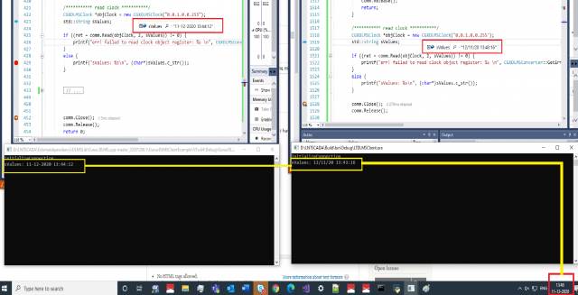

I am using latest version (20201208.1) of Gurux.DLMS.cpp-master. I have two sample application. Both sample application are running in same machine and showing different time format.
Ideally machine time format should be shown by the both application?
Kindly find the attached screenshot for the same.
Pradson
5 years 7 months ago
I believe that first application is calling locale to localize the time. Try to find this:
std::locale::global(std::locale(""));
