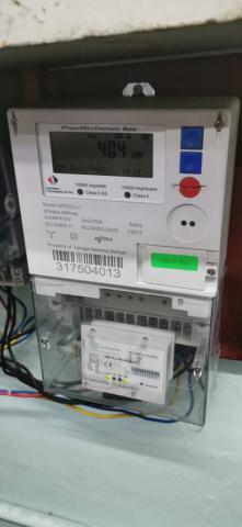

Thank you for your response. I have attached the meter picture that it supports DLMS.
I have also run the command as per advised but similar issue comes out, i.e. timeout.
Anything else that I need to look at?

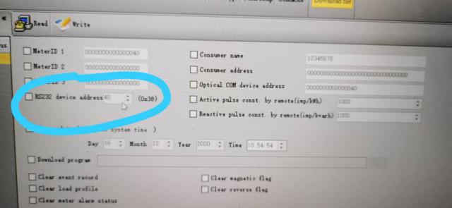

Additional info that might
Additional info that might help us. Below is my update command;
python main.py -h 183.171.144.38 -p 5001 -a Low -P 33333333 -t Verbose -i -c 13 -s 40
5 years 11 months ago
Can you get the trace from the send and received bytes in another application? If you can, I can check the correct settings for you.
