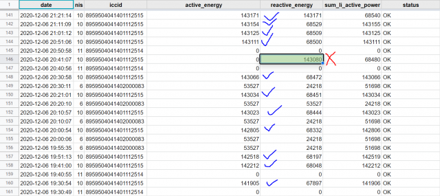

Hi, I'm having a problem when I use an xml file with several OBIS codes to perform readouts with the xmlClient. Sometimes the responses get mixed up.
These are the OBIS codes I'm reading
xml file link https://drive.google.com/file/d/18VCavxm5R-XO7zV9rFRxfhqw2EAbWBUd/view?…

Sometimes one value doesn't get sent back, for example active energy, then the other results get mixed up when writing to the database.
This is the part of my code which handles the replies

I also added the complete code which handles the reply in this link:
https://drive.google.com/file/d/1limqLA8M5e-VCxb1OLZuEAMePYIRHl9q/view?…
