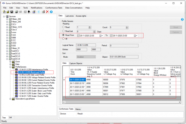

As I was facing the issue between the input time range and out put time range for block profile object is differ. But if I check the same scenario with DLMSDirector tool, then the result set is ok.
I have checked the above scenario with latest code as you had suggested me to add "cl.SetUseUtc2NormalTime(true)" but still I am getting the differences in result set.
Kindly find the below mentioned sample code and attached screenshot of DLMSDirector tool.
which line have I missed in the sample code? Kindly check.
