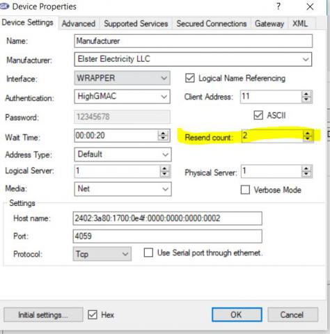

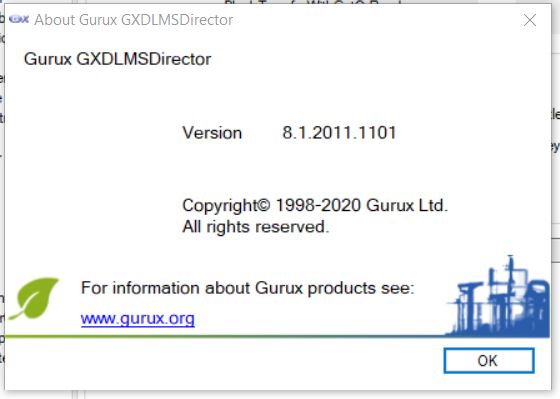

On Communication Retry of
On Communication Retry of Gurux Invocation Counter is not incremented in latest Gurux Version GuruX Version 8.1.2011.1101
5 years 9 months ago
We have tested this. Can you tell then the Invocation Counter is not increased in your mind?
thirumalesh
On Communication Retry of Gurux Invocation Counter is not incremented in latest Gurux Version GuruX Version 8.1.2011.1101. Because of this Communication and Meter is Failing and Gives
Error: GetObjects failed. Meter returns Service not allowed exception
Please check the attachment
Yes, Invocation Counter hasn't newer been increased because there is a historical reason for that.
Some older meters can't handle if the IC is not exactly correct.
In your case, the meter has sent the reply, and then it's lost on its way. Now IC is not increased and your meter rejects the next re-try.
In theory, increasing IC for re-try is easy, but there are several cases where it's causing problems if a message is lost after it's sent from the meter. for example, if data is written to the meter in multiple blocks is causing problems if one block is lost.
I need to think this a little bit and find a way how we can handle this in a generic way and keep legacy support.
