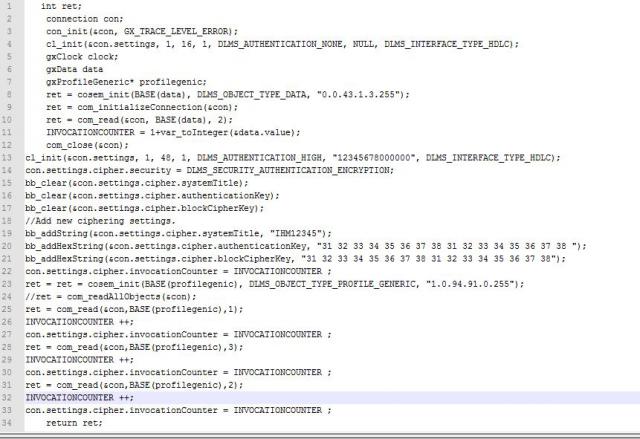

actually i am using atmel example source code.
it is having any problem.
You need to change the client address, password and authentication level. Something like this:
cl_init(&con.settings, 1, 32, 1, DLMS_AUTHENTICATION_LOW, "password", DLMS_INTERFACE_TYPE_HDLC);
hi sir
hi sir
please check the below code file and tell me where did i mistake.
You need to establish the connection again before reading the value. You don't call com_initializeConnection after you have set the ciphering settings.
