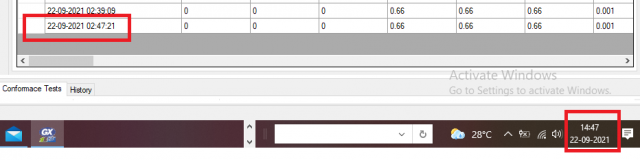

pradson
5 years 2 months ago
HI Mikko,
HI Mikko,
As suggested I have tried. Kindly find the below information and suggest.
(1) Try to create only one meter. Is the date-time now correct when you read it?
I have created one meter and tried still I am getting same time difference (12Hrs).
At the time when client read simulated meter-
System time: 22-9-2021 15:28:36
Fetched value string of instantaneous-profile-
22-9-2021 03:28:36 | 0 | 0 | 0 | 66 | 66 | 66 | 1 | 1 | 1 | 1 | 50 | 51 | 39 | 33 | 85807 | 1 | 110880 | 3 | 5 | 73456 | 15 | 11 | 97 | 07 E5 08 01 FF 00 00 FF FF 80 00 00 | | | | | | | | | | | | | | | | | | | | | | | | | | | | | | | | | | | | 70146 | | | 1 | | | | | | | | | | | | | | |
(2) Is the date-time correct with GXDLMSDirctor?
No, even the same time differenence(12Hrs) is appearing in GXDLMDDirector client app when I read simulated meter. Kindly refer attachged image.
(3) What is your time zone if you select clock object?
Kindly refer below information related to time zone-
Time Zone
Asia/Kolkata
Current Date and Time in Asia/Kolkata
Wed 22-Sep-2021 03:39 P.M.
Country
India
Daylight Saving Time (DST) in effect?
No
Most Recent DST Transition
DST ended on Mon 15-Oct-1945 at 12:00:00 A.M. when local clocks were set backward 1 hour
Next Scheduled DST Transition
There are no future Daylight Saving Time rules for this time zone.
12:00:00 A.M = MIDNIGHT
12:00:00 P.M. = NOON
Thanks & Regards,
Pradson
I believe that you have select "Use UTC time zone, not standard" at the device settings.
Get the latest version from the simulator. You need to start the simulator -d India parameter and simulator will use UTC to Normal time. You can read more from this:
http://gurux.fi/Gurux.DLMS.Objects.GXDLMSClock#deviation
Hi Pradson,
Hi Pradson,
You need to add that -d India parameter for the simulator. You need to use UseUtc2NormalTime also on the server-side. I believe that now the client is using it and the server doesn't. Change also

Thanks a lot for suggesting me. Now I am able to see the system time format in "Clock" and "instantaneous-profile" value string at client side. Its working properly as required.
I have another question regarding value strings of block-profile object. I have implement a timer for block-profile object. This timer captures block-profile object at every minute( Required is at every 5/15 Min but taking 1 minute for example). Kindly refer below mentioned code.
Whenever I read block-profile object using ReadRowByRange() method, then I get the value strings. Kindly refer value string below-
//---------- Value strings------------------------
23-9-2021 03:12:56 | | | | | | | | | | | | | | | | |
23-9-2021 15:13:11 | | | | | | | | | | | | | | | | |
23-9-2021 15:14:11 | | | | | | | | | | | | | | | | |
23-9-2021 15:15:11 | | | | | | | | | | | | | | | | |
I have two questions regarding value strings-
(1) The time format of the first value string does not match with system time. Even I have used "DateTime dt = DateTime.Now;" statement in the device side. The others strings have proper time format. Kindly suggest for first value string so that I could get proper system format at client side for all value strings.
(2) I am getting all values empty except clock. Why is it happening like this? How could I fill values at device side? Please suggest.

Hi Pradson,
Hi Pradson,
Date-time is not a string. You need to save it as an octet string where is date-time. The framework does this automatically when you add clock object as captured object list as the first object.
You need to fill captured object list so values are filled into the buffer.
Captured object list includes all values that are saved to the buffer.

(2) Observation of ReadRowByRange() method-
I have passed the from range 15-10-2021 01:05:00 and to range 15-10-2021 01:05:00 to read a single block data, then still I have not found any records.
I think if I set the second and milliseconds to zero, then it will be possible to achieve the expectation.
Kindly suggest for both cases.
Pradson
5 years 1 month ago
Hi Pradson,
Hi Pradson,
1. Profile generic makes the captures after power-up. You can remove that after you have start the meter.
2. Have you start the simulator with -d India parameter? What if the end time is 15-10-2021 01:06:00? Can you see the result?
pradson
5 years 1 month ago
In reply to Hi Pradson, by Kurumi
Kindly find the reply against the given points-
Yes, I have started with -d India.
Actually, I have seen In the real meter that the real meter captures the block data at sharp 5 minute like 01:05:00, 01:10:00, 01:15:00 and so on if capture period is 5 Minute. That's the reason I want to create a virtual meter which will appear like real one.
Kindly suggest.
Pradson
5 years 1 month ago
Hi Pradson,
Hi Pradson,
What I mean is have you try to read the data with ReadRowByRange where start time is 15-10-2021 01:05:00 and end time is 15-10-2021 01:06:00?
The reason why I asked this is that this works like expected in the test PCs. Can you try to read this with GXDLMSDirector where start time is 01:05:00 and end time is 01:06:00?
