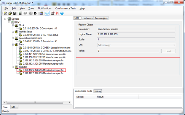

We would like to integrate indian standard L&T make ER300P meters using your Gurux DLMS .Net libraries.
As part of the requirement, we need to read only registers (Active Energy, Reactive Energy etc. with use of its OBIS codes) from its RS485 interface using serial communication. And few meters will be looped in daisy chain. so we need to read each meters registers one by one which are in the same loop.
examples provided are with reading of all the objects. but couldn't find a way to read registers alone.
So kindly provide complete code to read 1 or 2 registers from one meter. we will modify the same to read from multiple meters. it will be a great help if you can arrange the code for the above.
Thanks in advance.
Also attaching the sample screenshot of the meter data read from DLMS director.

The client example reads all the values from the association view. You can read register values only like this:
GXDLMSRegister r = new GXDLMSRegister("0.128.162.128.255");
com.Read(r, 2);
You need to add all values that you want to read and read them.
