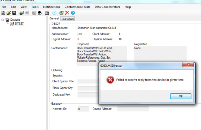

  3. I Need Connect DTZ27 To Gurux ?
i need connect DTZ27 to Gurux ?
By enhee88009932 , 22 October, 2020
Gurux.Serial

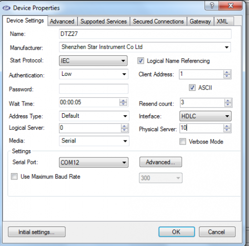

Image 2
Image 2

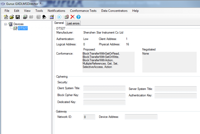

enhee88009932
5 years 9 months ago
Error image
Error image

The reason is usually in cables or baud rate. Check both and try with different baud rates.

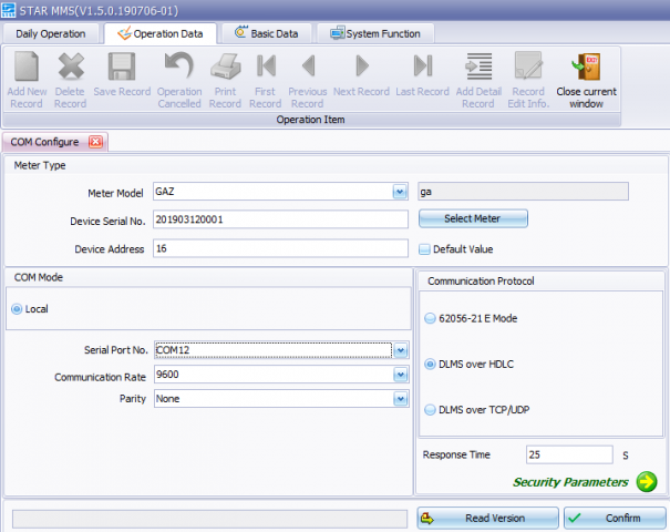

Star MMS use read data. but i need gurux ? not connect

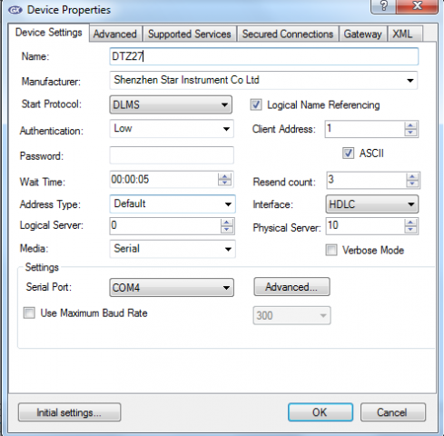

I notest that your serial port is different. Do you try to read data using an optical probe? If you, change the start protocol from DLMS to IEC.
enhee88009932
i using optical probe. and
i using optical probe. and error same " Failed to receive reply from the device in given time "
Select "View" | "Log" and "View Log". Is the meter returning anything?

13:40:14 Initializing serial connection.
13:40:15 IEC Sending:/?!<CR><LF>
13:40:25 Failed to receive reply from the device in given time.
System.Exception: Failed to receive reply from the device in given time.
13:41:14 Initializing serial connection.
13:41:15 IEC Sending:/?!<CR><LF>
13:41:25 Failed to receive reply from the device in given time.
13:42:09 Initializing serial connection.
13:42:10 IEC Sending:/?!<CR><LF>
13:42:20 Failed to receive reply from the device in given time.
13:42:36 Initializing serial connection.
13:42:37 IEC Sending:/?!<CR><LF>
13:42:47 Failed to receive reply from the device in given time.

1:44:55 PM Send SNRM request.
7E A0 07 2D 2D 93 8F BB 7E
13:45:00 Data send failed. Try to resend 1/3
13:45:05 Data send failed. Try to resend 2/3
1:45:10 PM Failed to receive reply from the device in given time.
13:45:10 Disconnect request
1:45:10 PM Send Disconnect request.
7E A0 07 2D 2D 53 83 7D 7E
13:45:15 Data send failed. Try to resend 1/3
13:45:20 Data send failed. Try to resend 2/3
1:45:25 PM Failed to receive reply from the device in given time.
The meter should answer to /?!<CR><LF>. You need to check the baud rate.
The default baud rate is 300, but I believe that your meter is using something else. Can you read IEC Local port Setup object. 0.0.20.0.0.255? It should show the default baud rate.
