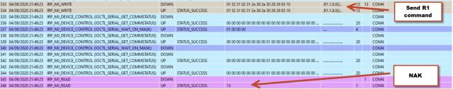

Anyway I'd like to ask you about a problem with reading the data from Landis E550. I've managed to set the communication with the meter but I got stuck when I try to force a read command. Here is what I get:
<- /LGZ5\2ZMG410000b.P07 //(device responds correctly)
-> <ACK>001 //(I've decided to stay with 300bps)
<- P0.(BE00B600) //(device responds correctly)
And now I want to send the reading command - here is what I send:
-> <SOH>R1<STX>1.8.0()<ETX><BCC> //(0x01, 0x52, 0x31, 0x02, 0x31, 0x2e, 0x38, 0x2e, 0x30, 0x28, 0x29, 0x03, 0x10)
And I get <NAK> response:
<- 15 //0x15 = NAK
Below you can find a screen from COM sniffer with reading command and NAK response. So there is definetely a problem with R1 command - I'm not sure if I've defined a data block correctly - on the other hand I've found similar cases on the forum and R1 commands look the same (https://www.gurux.fi/node/4573 ).
Does this problem mean that the meter needs a password? This meter is brand new, I got it directly from the producer and I have it on my desk for tests (it does not belong to energy company). Do these meters have any default password?
I'd be grateful for any hint what can be wrong here.

I propose that you use DLMS and not IEC 62056-21. DLMS is not ASCII, but there are a lot of features that are not in IEC 62056-21, ex. ciphering. IEC 62056-21 is easier, but it's the old way and DLMS is new. Check libraries for different languages from Github.
It might be that password is required or then message is wrong. It's hard to say because I don't know is meter requiring the password.
