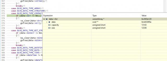

I am using GuruxDLMS.c to try reading object logical name 0.0.0.2.1.255, attribute 2, HLS using GMAC, connects ok.
Following the http://gurux.fi/Gurux.DLMS.Client readObject example.
The call to cl_updateValue causes a hard fault due to an impossible pointer value.
I could track it to file variant.c, line 373, data->Arr is not NULL but data->Arr->data has a value that is not reachable.
See the picture below.
My system is gcc GNU Tools for STM32, version 7-2018-q2-update, with the following flags:-mcpu=cortex-m4 -std=gnu11
-g3 -Og -ffunction-sections -fdata-sections -Wall -Wextra -fstack-usage --specs=nano.specs -mfpu=fpv4-sp-d16
-mfloat-abi=hard -mthumb.
Please ask me for more information if you need it.

I was trying to read the object with logical name "0.0.0.2.1.255" it is an octet-string[15] with the firmware version.
I can read this with GXDLMSDirector. I was wondering if this can be a problem with initialization of the object argument to the function cl_updateValue.
I am using a STM32F413 microcontroller with 320KB of SRAM with freeRTOS.

Are you sure that you try to read the firmware version? In your picture, your data is coming back as array, structure, or compact data.

yes, I am sure I tried to read firmware version. The code went to that case because the type in object was filled with DLMS_DATA_TYPE_STRUCTURE and I don't know why...
In any case, when I initiated the object structure like this:
static gxObject object;
unsigned char memoryArea[256] = {};
object.access = (gxAccess*)memoryArea;
bb_init(&object.access->methodAccessModes);
bb_init(&object.access->attributeAccessModes);
bb_capacity(&object.access->methodAccessModes, 50);
bb_capacity(&object.access->attributeAccessModes, 50);
I didn't get any more hardfault.
Is this correct? Shouldn't this be done automatically by gurux?

At this moment I can't use GXDLMSDirector, but I can get you the bytes if you tell me exactly where to put a breakpoint in gurux. Is it at the same point I showed in the picture?
I have not defined DLMS_IGNORE_MALLOC.
José Torres
5 years 11 months ago
Yes, that is the location.
