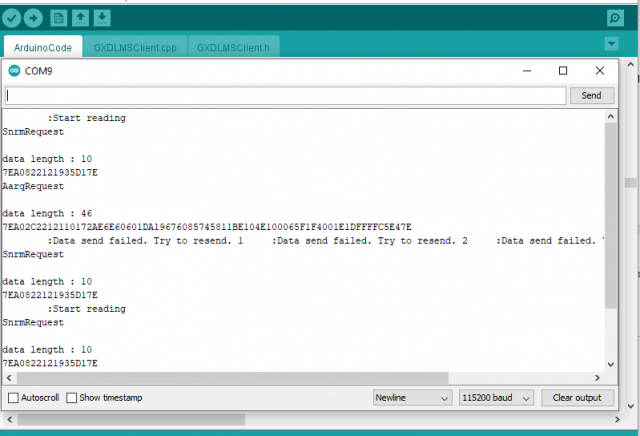

i am working on electric meter. I upload Gurux.DLMS.c arduino code to NodeMCU(ESP8266) to read the meter throught Optical Port. The uploading is successfully done, but it cannot access the meter.
The output (also it is shown on the image attached):
Start reading:
SnrmRequest
data length : 10
7EA0822121935D17E
AarqRequest
data length : 46
7EA02C2212110172AE6E60601DA19676085745811BE104E100065F1F4001E1DFFFFC5E47E
Data send failed. Try to resend. 1 :Data send failed. Try to resend. 2
I Think the AarqRequest is correct but no response.

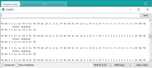

Is your UART correct? Join your Arduino to the PC and you can see if the bytes are coming from the serial port.
HERO
5 years 11 months ago
Yes. Already the meter send the response and I checked that it is correct. But it cannot continue. It keeps sending SnrmRequest only.
see the output:
:Start reading
7E A0 8 2 21 21 93 5 D1 7E
7E A0 8 2 21 21 93 5 D1 7E 7E A0 1F 21 2 21 73 56 F4 81 80 12 5 1 80 6 1 80 7 4 0 0 0 1 8 4 0 0 0 1 53 3B 7E
:Start reading
There are numbers missing from the trace and I can't verify the messages. Try to change your trace baud rate from 9600 to 115200. Don't add the image. It's hard to get the bytes. Add plain text.
HERO
I tried to change the baud rate but I got the output from meter only at 9600.
The output is :
:Start reading
I let the arduino to print byte by byte separated with SPACE . some bytes are displayed with removed MSB zeros. for example after A0 , 8 it is 08 .
The output after adding MSB zeros:
:Start reading
7E A0 08 02 21 21 93 05 D1 7E
7E A0 08 02 21 21 93 05 D1 7E 7E A0 1F 21 02 21 73 56 F4 81 80 12 05 01 80 06 01 80 07 04 00 00 00 01 08 04 00 00 00 01 53 3B 7E
It is correct , but the meter didn't continue.
I know the reason for this. Your serial port is echoed the received packets. This causes the problem. We'll improve the Arduino example to handle echoed messages.

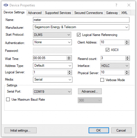

The meter settings is shown in the image below.
5 years 10 months ago
The hex string that you have added here is not correct. Can you use hex library that adds all zeroes?
Also check why the last bytes are wrong.
E6 E6 00 60 1D A1 09 06 07 60 85 74 05 08 01 01 BE 10 04 0E 01 00 00 00 06 5F 1F 04 00 00 02 14 FF FF

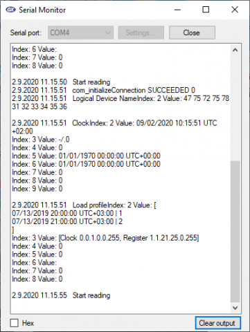

Try to connect with GXDLMSDirector and check are you getting the same error. If you do, try to reboot the meter.
HERO
I tried with GXDLMSDirector and it connected without errors.
I tried to reboot the meter and connect again, but the error is still.
You are sending SnrmRequest twice. That is the only difference. Check why you are doing it.
