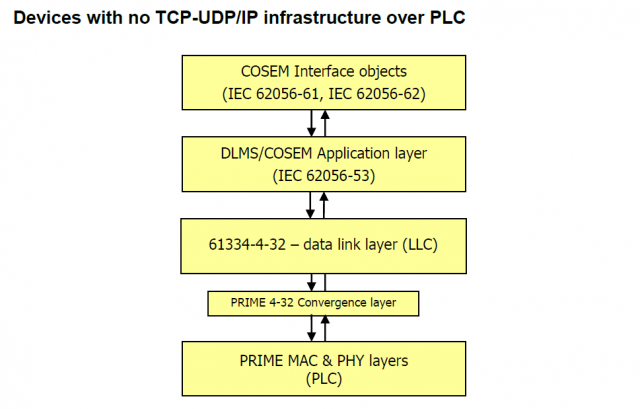

We are interested to implement a communication profile based on the protocol Prime through PLC (check the scheme in the picture attached).
Like we know when using the serial communication or TCP-UDP we are choosing the interface HDLC in the gurux client as protocol of communication. The connection starts always by an SNRM request from the client followed by an UA frame from the server then the AARQ and AARE (application layer).
In case we want to implement the Prime PLC, do you have any idea and information about the interface we should use? what are the requested step to do before reaching the DLMS/COSEM application layer AARQ and AARE? Do you intend to implement any of this protocol?

IPV6 and IPv4 are using IEC 62056-47. They are already implemented. Interface type is WRAPPER.
We are testing S-FSK PLC (IEC 61334-4-32) parser at the moment.

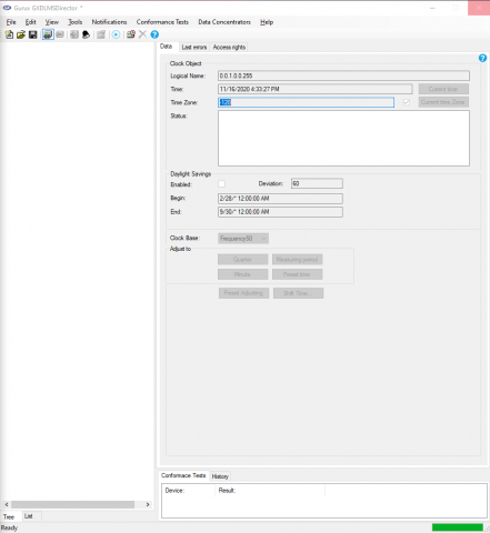

We downloaded the latest version of GXDLMSDirector and we faced a very weird and dangerous issue.
After connecting, we tried to read, write and trigger some methods, everything looked fine. However, when we tried to set the current time through the clock object, the GXDLMSDirector is totally crashing like you can see in the attached picture. The connected device disappeared and the director wasn't responding anymore.
We tried to follow the writing process of the clock time on the server side, everything looked good. So we thought that the problem was from the client side.
The last PDU sent by the client before crashing was:
7E A0 27 03 25 58 E3 91 E6 E6 00 C1 01 C1 00 08 00 00 01 00 00 FF 02 00 09 0C 07 E4 0B 10 FF 10 30 14 FF FF 88 00 85 10 7E
Can you please check the possible reason behind this major issue?
Can we have access for an older GXDLMSDirector version so we can test if the problem is coming from the new release or not?

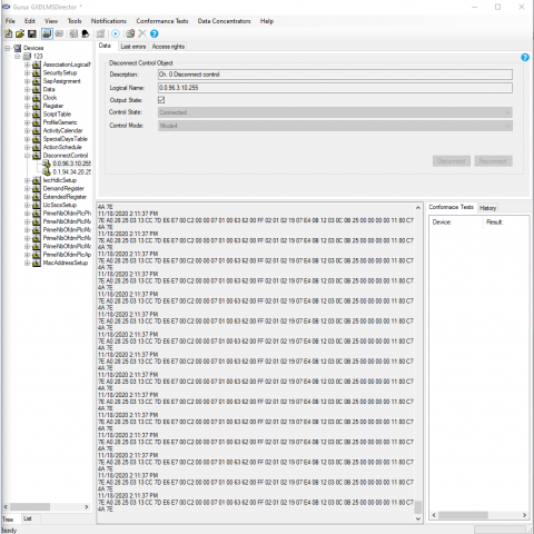

We are using the sendEventNotification to transmit the message through serial. We were able to narrow the problem. In fact, when we were transmitting the event notification message the same message was sent continuously like you can see in the picture. The unstoppable sending message is causing the crashing of the GXDLMSDirctor.
Can you check if this problem is due to the client?
Is the function sendEventNotification working fine on your side? If yes, we will conclude that the problem is coming from the server side.

If you are sending the same push message in a loop like in your pic it will cause problems for the client. You need to change this and send push message(s) only once or max a few times.

We think that you got us wrong. In fact, we are sending the above push message one time only. To be sure of that, we sent the push message on an another com port and watched through Docklight the transmission instead of sending it on the same port using to communicate with the client. The push message is send only once like expected. This assured that the problem is coming from the client side not the server side.
When we tried to send this same message once to the GXDLMSDirector, it was like it is blocking in a loop and the same message appeared repeatedly in the event notification dialog leading to the crashing of the GXDLMSDirector. It seemed like the server is sending the message multiple time but in reality (like described in the test above) we are sure that the push message is sent only one time from the server side.
If you need more information to solve this issue don't hesitate.

Can you add raw bytes from the push message here? We have tested this in several different ways and it works every time without problems.

We are checking again if the problem is arising from our side. What do you mean by this question "Can you add raw bytes from the push message here? "? can you explain it because we did not understand?

There is a trace from the received bytes in the pic above. Because the pic is compressed, I can't read the bytes. Can you add one push message from the notification view to here so we can check it.
lara.wakim
5 years 12 months ago
Yes sure, the push message of the pic above is:
7E A0 28 25 03 13 CC 7D E6 E7 00 C2 00 00 07 01 00 63 62 00 FF 02 01 02 19 07 E4 0B 12 03 0C 0B 25 00 00 00 00 11 80 C7 4A 7E
Another push message tested just right now:
7E A0 28 25 03 13 CC 7D E6 E7 00 C2 00 00 07 01 00 63 62 00 FF 02 01 02 19 07 E4 0B 18 02 0B 1A 02 00 00 00 00 11 80 D6 E6 7E
