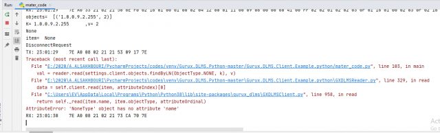

I am working with Gurux.DLMS Python to read electric meter (company SAGEMCOM). I successfully got read some general data from the meter.
I tried to read the active power and some data (e.g. logical object 1.0.0.9.2.255) from the meter through gurux.DLMS.Python, but it displayed an error I think it means that no logical name found for this. But this logical name is correct.
How can I read these logical objects?
I want to read the power consumption from the meter.
6 years 3 months ago
Make sure that this object is in the association view. All the objects are not available if authentication level is wrong.
If you know the object type you can also read them without reading the association view. You just create the object and read them. Like this:
r = GXDLMSRegister("LOGICAL_NAME")
#Read scaler and unit.
self.read(r, 3)
# Read the value.
self.read(r, 2)
