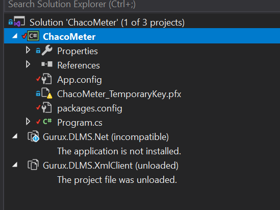

I've come back to an old DLMS project which was working last year, using Gurux dotnet. After updating the dependencies I get this error:
Gurux.DLMS.Net (incompatible) the application is not installed.
and
Gurux.DLMS.XmlClient (unloaded) the Project file was unloaded.
But searching in NuGet, those packages don't exist any longer. I can't find the documentation either.
How can I solve these issues?
Thanks for your work

The package name is Gurux.DLMS. Search it from the Nuget.org.
