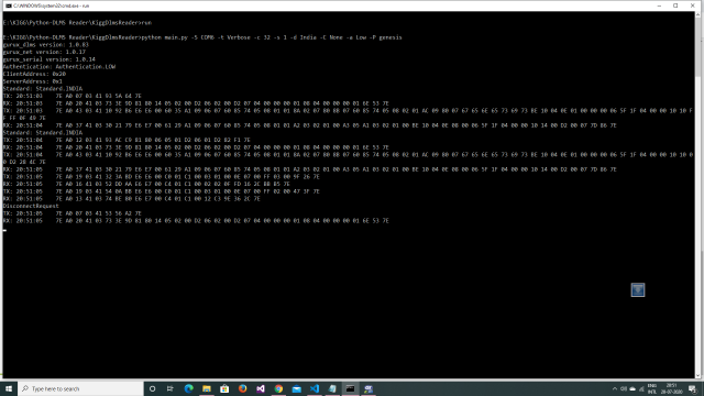

As advised by you I changed the code to read Frequency. I checked the logical name from GXDLMSDirector. I am attachng the screen shot of what I got from the meter.
Could you please guide me if this is correct and how to get the Frequency value and unit?
Regards
Ajit

Please, don't add pics like this. They are compressed and others can't read them.
You can get the value like this from the register object:
print(it.value)
