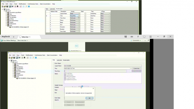

No I am using secure standard FX 100. I have tried but failed. Please find Scree.

Thank you for reply.
In shared screen shot, I have provided read and write access and request connect. On connect I read time and again write back same date time without any change. Error is shared in above screen.
5 years 11 months ago
You don't provide access right, meter does. If you read association view, is access right readWrite?
When I read association view, it has read access. I change it. Please find details. reading association , read clock and write clock.
If i don't provide readwrite access , then it is disable, how to writer it ? as suggested, I tried writing same date time. but same issue.

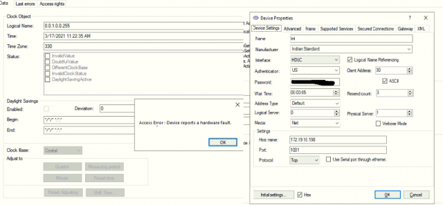

5 years 2 months ago
Now i have High level password for L&T meter, as guided by you, association view has read write access for Time OBIS code.
While using directrix i am selecting Manufacture as Indian Standard, interface =HDLC, authentication = "US". using it am able to fetch all parameters now but Still the time sync is not happening. it through error as "access Error: Device reports a hardware fault"
Also while using .net code example i am not able to see "US" as authentication options.
Kindly help for doing time sync.

In reply to Hi Mikko, by sachinar007
Hi Sachin,
Hi Sachin,
Your settings seem to be ok and the meter should reply.
US is High authentication where the client address is changed to 48 (0x30). It's added to GXDLMSDirector to help reading.
