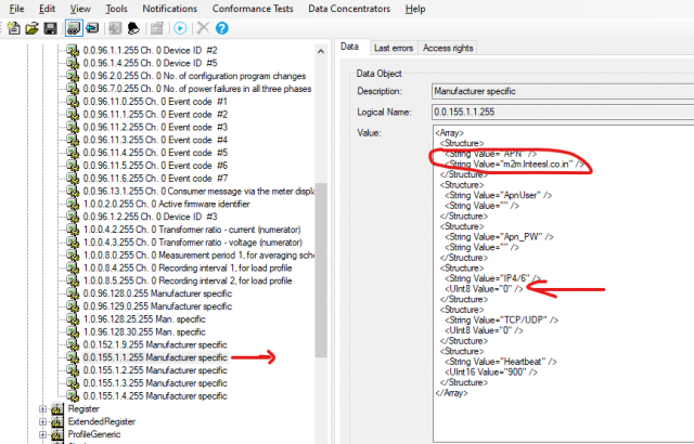

I'm using GXDLMSDirector version 8.2.2006.1201, But I'm Unable to change APN (OBIS code 0.0.155.1.1.255) for my smart energy meter. Screenshot is attached here. Please let me know what can be done to change the APN.

For some reason meter manufacturer is not using GPRS modem setup and it's using custom interface for this 0.0.155.1.1.255.
Try to change APN and write it back. Because this is not a standard way you need to ask this from the meter manufacturer if this is not working.
