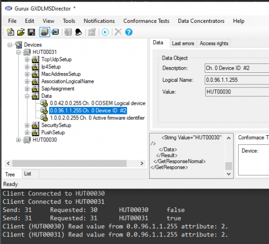

On screenshot you can see console output. I was connecting with server address 31 and server HUT00031 returns true in isTarget, second server HUT00030 returns false.
But I still got in DLMSdirector LDN name of the wrong server.
