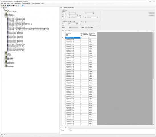

I am currently using the DLMS
I am currently using the DLMS_USE_EPOCH_TIME definition in gxignore.h.
I tried different time intervals in the UNIX format. It is known that in these time limits there are entries in the counter. However, a full read occurs. I even tried to set a zero time interval - the result is the same.
Can you read your meter with GXDLMSDirector? - yes. What should I do?
6 years 2 months ago
Add readRowsByRange read request from GXDLMSDirector and ANSI C here. I'll check what is different in the messages.

Attached the debug output of the exchange when requesting a profile. The results in both cases are the same. Apparently the library did not come across such a meter!

From the pic it seems that meter is also returning external rows with GXDLMSDirector. Not just between the selected range. If this is true, ask the meter manufacturer to fix this.

Other app don't use deviation or status, I believe that your meter can't handle deviation and it breaks this. You should ask the meter manufacturer to fix it.
Other app:
<!-- 14.5.2020 12.49.08.820 -->
<DateTime Value="07E4050EFD0C3108528000FF" />
<!-- 15.5.2020 12.49.14.240 -->
<DateTime Value="07E4050FFD0C310E188000FF" />
Your app:
<!-- 14.5.2020 13.16.00 -->
<OctetString Value="07E4050E040A100000000000" />
<!-- 15.5.2020 13.16.00 -->
<OctetString Value="07E4050F050A100000000000" />
You need to ignore them. Something like:
gxtime start;
time_init(start...);
start.skip = DATETIME_SKIPS_DEVITATION | DATETIME_SKIPS_STATUS;
cl_readRowsByRange2(settings, pg, &start, ...)
