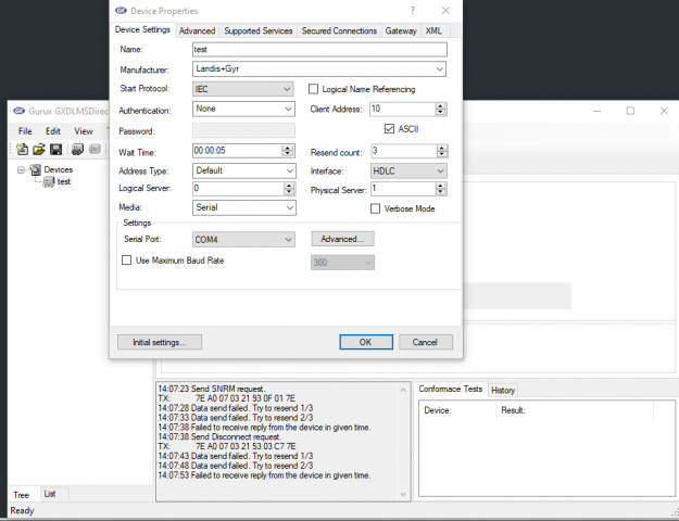

Nope, u can see below, I read
Nope, u can see below, I read that the optical interface needs handshake before connection, but it starts with SNRM frame.
13:13:33 Send SNRM request.
13:13:38 Data send failed. Try to resend 1/3
13:13:43 Data send failed. Try to resend 2/3
13:13:48 Failed to receive reply from the device in given time.
13:13:48 Send Disconnect request.
TX: 7E A0 07 03 21 53 03 C7 7E
13:13:53 Data send failed. Try to resend 1/3
13:13:58 Data send failed. Try to resend 2/3
13:14:03 Failed to receive reply from the device in given time.
BR
Piter

Have you changed this?
If you are using optical port change "Start Protocol" from DLMS to IEC.
Pezet032
6 years 3 months ago
Yes offcourse.
Yes offcourse.
In your first post you said that you are using a virtual com port. Do you have a virtual COM port or are you using an optical probe (head) that is connected to USB?
Try to select "Use maximum baud rate". It helps with some optical probes. Communication is slow, but you can check if communication works.
What optical probe you are using (modem and manufacturer)?

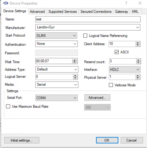

So if I connect via serial
So if I connect via serial port i will start e.g. from 9600 8n1 (I know it's programable baud rate), but still it will be IEC right?
BR
Piter
Hi Piter,
Hi Piter,
If you are connecting using serial port your meter is communicating directly using DLMS and IEC is not needed. IEC is needed when communicating using an optical port to change the baud rate from 300 ti higher one and moving to binary mode.

So, if I understood correctly, when I'm sending "/?!\r\n" imeter starts to operate with IEC 62056-21. But is it possible to start with DLMS using serial port or I must still start with IEC and move to mode E?
Because it's still looks like it operate in this same way like from opto port, but only difference is baud rate, becuse we starting at 9600.
I tried both methods but still unsuccessful. When I try to start with IEC it's sending "move to mode E" frame but sometimes it's too late because I have standard reply with data, and sometimes just no reply like bellow:
08:14:31 Send SNRM request.
08:14:36 Data send failed. Try to resend 1/3

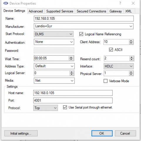

Right now I'm using moxa
Right now I'm using moxa rs232/485 converter to tcp, no ser2net because ser2net didn't work properly like u said. My connection parameters looks that:
Hi Piter,
Hi Piter,
You must set the same serial port settings to Moxa as in the meter or it doesn't work.
