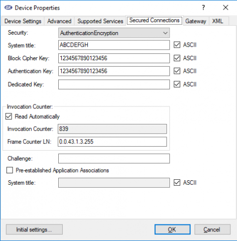

We are using latest stack and compiled successfully. When we try to pass Authentication key and Ciphered key, Below error getting.
Where as in DLMSExplorer we have selected ASCII checkbox and its working.Attached image for your reference
./bin/gurux.dlms.client.bin -S /dev/ttyUSB0 -c 48 -s 1 -a High -P "0000000001035820" -C "AuthenticationEncryption" -g "0.0.13.0.0.255:9" -v "0.0.43.1.3.255" -t "Verbose" -T "4142434445464748" -A "1234567890123456" -B "1234567890123456"
Invalid authentication key '1234567890123456'
If we pass as "31323334353637383930313233343536" we are getting the same error
Now in ANSI C how to send Authentication key and Block ciphere key?

All ciphering keys are given as hex string. Try like this, without brackets:
-A 31323334353637383930313233343536
Mohanraj
6 years ago
Thanks. It working without backets
