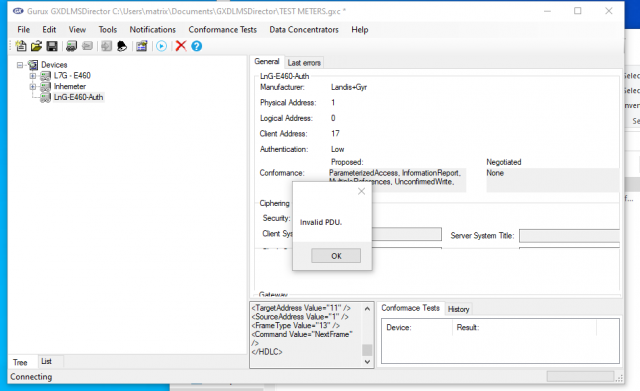

I'm also facing the same error in GXDLMS DIRECTOR (see the attached)

Hi Mikko, this is the GXDLMS
Hi Mikko, this is the GXDLMS Director trace leading me to the error "Invalid PDU":

Your meter is returning invalid PDU. One of your settings is different that meter expects and it's causing this. Can you read your meter with Map110 and send trace from the three first messages that client sends. I can check the correct parameters for you.
