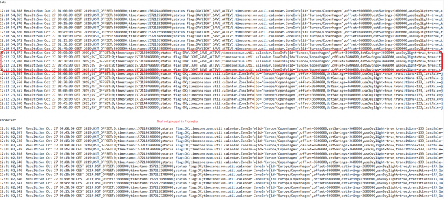

I promised to post some logs
I promised to post some logs (image) from both L+G and the Prometer for the same scope, which is:
start = 2019:9:27 0:0:0 end = 2019:9:27: 4:0:0 - no tampering in timezones, default for my location is Europe/Copenhagen.

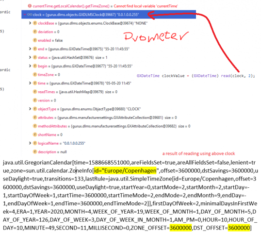

In attachment (image) could
In attachment (image) could be found a clock and result of reading time from the Promoter meter as you requested.
Still, I do not have any idea how to proceed :)

Please, don't post images. You can see them fine, but they are compressed and from other PCs they are fuzzy. I can't read the first image at all.
It seems that your Prometer is using UTC time zone, is that correct? Did your read attribute 3?
Can you read your clock with GXDLMSDirector? It'll read all the attributes automatically.

Sorry, about these pictures. Indeed, I noticed that the one attached is useless.
GXDLMSDirector told me:
time - 05.05.2020 15:06:24 - which is 1hr back to my zone time.
time Zone = 0
In other words exactly as you said.
This was my first time with GXDLMSDirector (sorry to say that, I am a newbie), but I have also made a read from the profile, which I am interested in, for a given scope and there were following results (copy-paste of clock column from GXDLMSDirector ). They are aligned with the results I posted in my previous comments.
But, UTC is a standard, not a timezone, which is a key to the solution. Logs from my program were a little bit misleading for me and the ignorance the Prometer works in UTC were the reason for my problems.
Thanks a lot for your patience and your time I think I will be able to handle that in my program.
