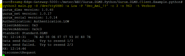

Greetings,
Dear All,
I am using the GURUX UI in windows and it does work perfectly but when I use the Linux Version or even the terminal version in windows it says there is no data:
Win UI:- Connected and there is data
Linux or Windows PowerShell:- Not Connected
Image in next comment

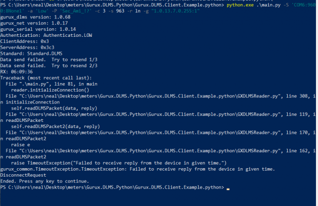

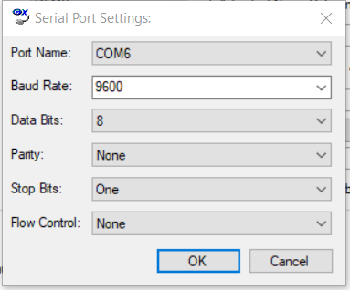

Windows Conf:
Windows Conf:

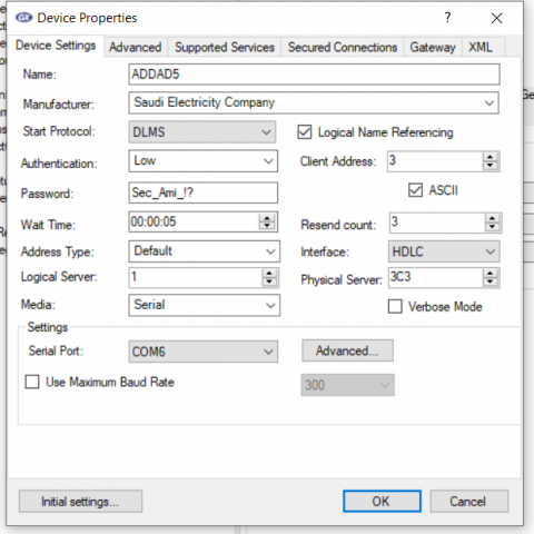

this is the test using Server
this is the test using Server address you gave: in the user interface i used 963 and it converted it to 3C3 and it does work.

I'm sorry, but we can help only our clients by telco. Your logical address is set to one in GXDLMSDirector. That is the reason why you must use 17347.
Your data matches for GXDLMSDirector settings.
7E A0 0A 00 02 0E 87 07 93 0F C4 7E
Check your serial port settings. What is baudrate in GXDLMSDirector?

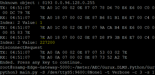

I finally made it, you were
I finally made it, you were really helpful, I appreciate your hospitality.
you can see both the current then the voltage, I have then to multiply them by 0.001 to get the correct scales.

one last question, How did
one last question, How did you calculate the address, it was:
logical = 1
physical = 963
and then it is 17347, How did you do it?
6 years 2 months ago
May I ask what was the reason? I have explained the address counting here:
https://www.gurux.fi/dlmsAddress
