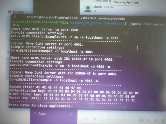

Hi Sir,
Hi Sir,
I run that server and client code. But it showing something like ( I attached photo. It is from server side ).
Shakti
6 years 3 months ago
There are four DLMS server up and running. You can connect an example using GXDLMSDirector. Select Gurux to the manufacturer and set the port to 4061. Or run client examples using connection settings as described.
