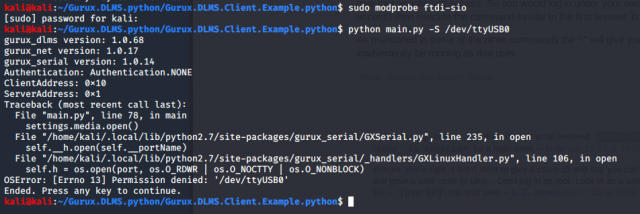

Im trying to connect a EMH meter LZQJ-XC (https://www.emh-metering.de/en/products/spezialzaehler/lzqj-xc) using GURUX Linux version and Python without success. I really dont know the default settings of these meters in the Tools/Manufacturer Menu, and when created, in the Device Properties.
We are using usb optical probe IEC 62056-21 for our connection

You don't have access rights for your serial port. You need to run this with sudo or add access rights to the serial port for your user. Try with this:
sudo gpasswd --add ${USER} dialout

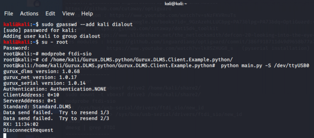

Thanks for the reply, I try
Thanks for the reply, I try this command (sudo gpasswd --add ${USER} dialout) and it works I have access to serial port but I can't connect with the smart meter
6 years 3 months ago
Try to add -i parameter. I can't remember is EMH using IEC 62056-21 when the connection is established using the optical head. You can try to change the baud rate if this fails.
