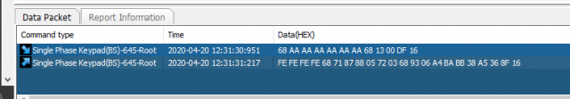

I have connected to the meter
I have connected to the meter using the Inhemeter Smart Tools app.
I have attached the trace shown when I 'fired' the connect meter command
6 years 3 months ago
I'm sorry to say, but this is not DLMS protocol message. This is a proprietary protocol that they are using in own app.
Can you download GXDLMSDirector and select "IEC" as start protocol? or run your Python command line app with -i parameter.

6 years 2 months ago
Try with settings below:
-s 1 -c 18 -a Low -P 12345678 -w
